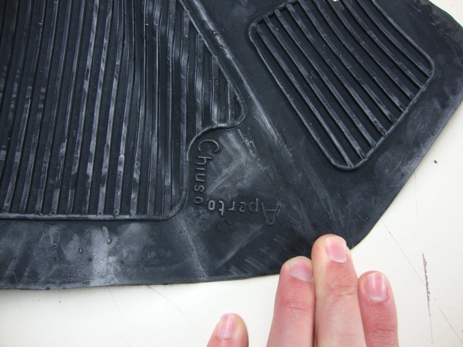

                      Un po’ di fotine
                      C30A81AB-70AA-48D7-9590-C9E0C13CB921.jpeg E4E5CDB6-A4F4-452F-A000-79971894BC2A.jpeg F2B19419-994B-482C-A9DE-262C32EF6E9A.jpeg 99F5E231-5FF5-4F50-8840-B41F758493F1.jpeg 1B8E8F70-EEFB-45AB-8CC9-65A433C514CA.jpeg

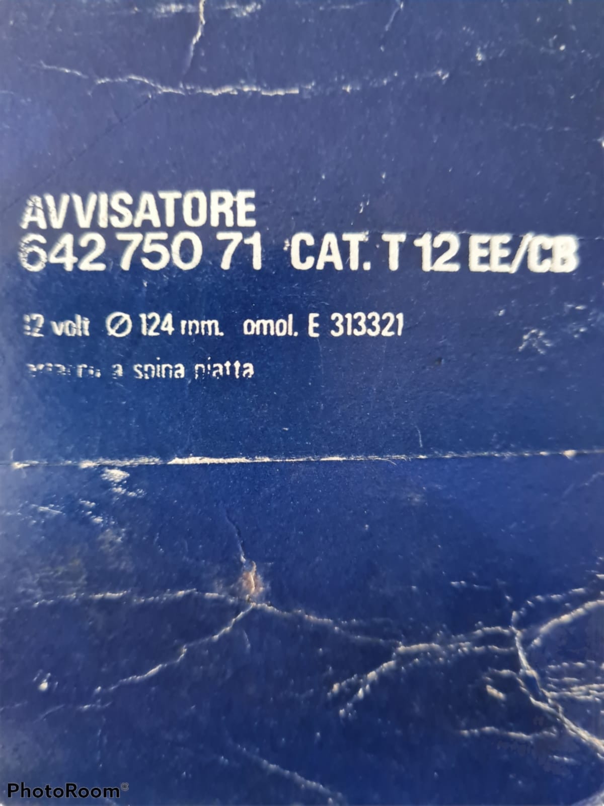

                      Romano65
                        A5507552-42B5-43A5-ACC6-78FBA99C057E.jpeg 19A559F9-1800-4456-AB9A-5CB16869BB34.jpeg 688C9976-0B8A-443B-941F-0059C443A1D2.jpeg
